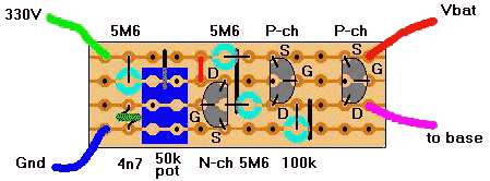

Voltage regulator board in situ, showing inverter transformer with its outer insulation and 4 turns removed (pic1). Detail of voltage regulator board (pic2):
Suitable board layout. Component side view. Cuts in the tracks on the underside are indicated by thick black lines. The board should can be somewhat bigger than shown to allow room for a mounting hole.
